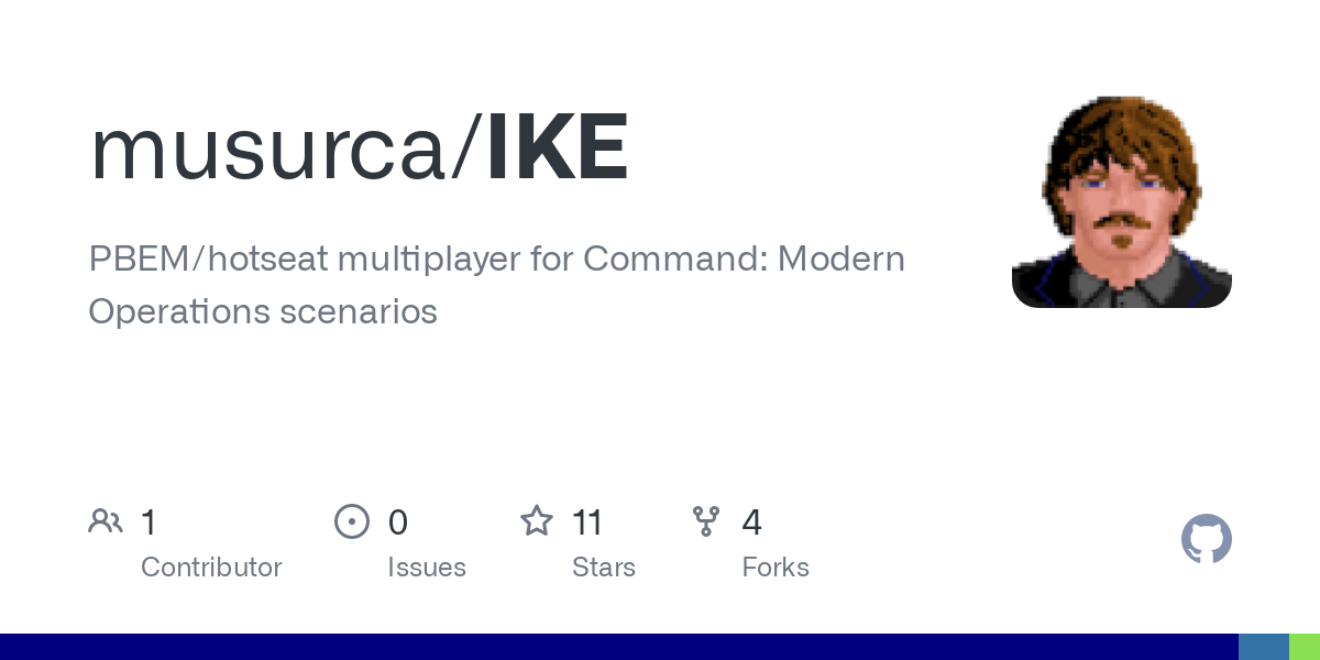

Licensing & Source Code
IKE is licensed under the GNU GPLv3 , a free and permissive open source license that allows you to do whatever you want with it, as long as you provide source code for any modifi cations you make. Th e full text of the license is included with this release.
The unminified source code for IKE, along with instructions for building it, are available on GitHub here:
